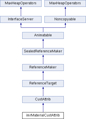

| virtual bool | GetOpaque (TimeValue t=0) const =0 |
| virtual void | SetOpaque (bool val, TimeValue t=0)=0 |
| virtual Texmap * | GetShader (ShaderSlot slot) const =0 |
| virtual void | SetShader (ShaderSlot slot, Texmap *shader)=0 |
| virtual bool | GetLockEnabled (ShaderSlot slot) const =0 |
| virtual void | SetLockEnabled (ShaderSlot slot, bool enable)=0 |
| virtual bool | GetShaderLocked (ShaderSlot slot) const =0 |
| virtual void | SetShaderLocked (ShaderSlot slot, bool lock)=0 |
| virtual bool | IsShaderLocked (ShaderSlot slot) const =0 |
| virtual SClass_ID | SuperClassID () |
| | Retrieves a constant representing the type of the plugin. More...
