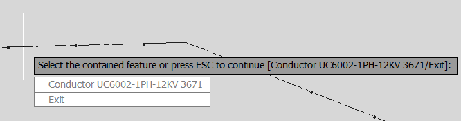

    If the selected feature contains other features, you are prompted to specify the feature for which to insert the detail block.
  3. Do any of the following:
    • Press ESC to specify the container.
    • Click a contained feature from the list.
    • Click Exit to bypass further options and insert the detail.
