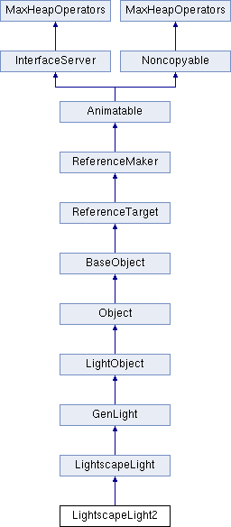

#include <lslights.h>
Extension to Photometric light This interface extends class LightscapeLight with new functionality in 3ds Max 2016.

enum | LightTypes { TYPE_BASE = 532, TARGET_POINT_TYPE = TYPE_BASE + 0, POINT_TYPE = TYPE_BASE + 1, TARGET_LINEAR_TYPE = TYPE_BASE + 2, LINEAR_TYPE = TYPE_BASE + 3, TARGET_AREA_TYPE = TYPE_BASE + 4, AREA_TYPE = TYPE_BASE + 5, TARGET_DISC_TYPE = TYPE_BASE + 6, DISC_TYPE = TYPE_BASE + 7, TARGET_SPHERE_TYPE = TYPE_BASE + 8, SPHERE_TYPE = TYPE_BASE + 9, TARGET_CYLINDER_TYPE = TYPE_BASE + 10, CYLINDER_TYPE = TYPE_BASE + 11, LAST_TYPE = CYLINDER_TYPE } |
Types for the lights. More... | |
enum | DistTypes { ISOTROPIC_DIST = 0, SPOTLIGHT_DIST = 1, DIFFUSE_DIST = 2, WEB_DIST = 3, LAST_DIST = WEB_DIST } |
Types for the distributions. More... | |
