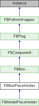

+ Inheritance diagram for FBBoxPlaceHolder:
