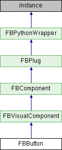

#include <mobu-python-api.h>
Used to create and manage buttons in a user interface.
This class includes functionality to create buttons in a user interface and add a callback. In MotionBuilder, buttons are created within regions, which are in turn created in layouts with FBLayout. For usage, see the Python sample Button.py. See also: FBButtonStyle, FBTextJustify, FBButtonLook.
