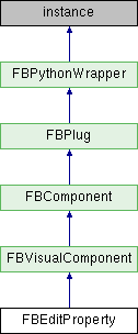

+ Inheritance diagram for FBEditProperty:
