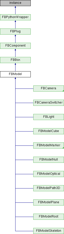

Inheritance diagram for FBModel:Public Member Functions | |
