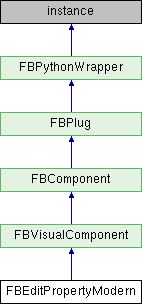

+ Inheritance diagram for FBEditPropertyModern:
