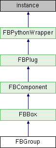

Objects Grouping class.
This class is an interface to manipulate object's grouping in the scene.
Inheritance diagram for FBGroup:Public Member Functions | |
