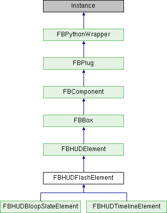

+ Inheritance diagram for FBHUDFlashElement:
