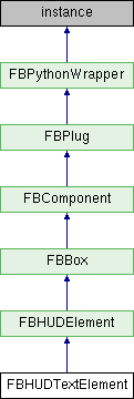

+ Inheritance diagram for FBHUDTextElement:
