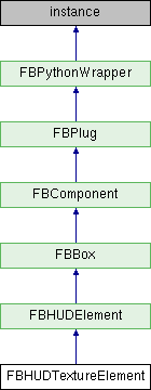

+ Inheritance diagram for FBHUDTextureElement:
