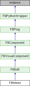

Class Description
Multi-line text input.
+ Inheritance diagram for FBMemo:
