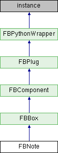

Class Description
+ Inheritance diagram for FBNote:
