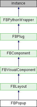

#include <mobu-python-api.h>
Popup window.
This class lets a window (inheriting from FBLayout) be created for another interface.
