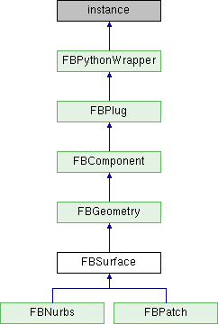

Surface class.
Inheritance diagram for FBSurface:Public Member Functions | |
