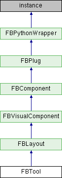

Tool class.
Inheritance diagram for FBTool:Public Member Functions | |
