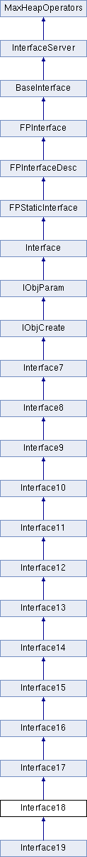

Interface18 Class Reference
Interface18 Class Referenceabstract
#include <maxapi.h>
Class Description
Extends Interface17 Client code should retrieve this interface using GetCOREInterface18.
+ Inheritance diagram for Interface18:
