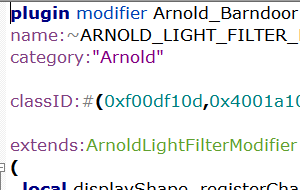

Scripted Plug-ins: Scripted Plug-ins now support new parameter types of #paramBlock2 and #point2. Scripted Plug-ins now support new parameter event handlers preSet and postSet that are guaranteed to use the original and new parameter value respectively. Scripted MAXtoA plug-ins can now be created for Arnold nodes. | TrackView:There are new filter flags for TrackView: #activeLayer and #unlockedTracks. There is a new method to test flags, testFilter() .The Mixin Interface trackviews.current.ui now exposes the getToolbarObjectName method to retrieve the non-localized toolbar name. By contrast, the getToolbarName method returns a localized string. |

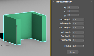

Geometry Objects Type-in Properties:The Keyboard Entry properties for several geometry objects are now exposed. These properties are now available for Box, C_Ext, ChamferBox, ChamferCyl, Cone, Cylinder, L_Ext, Prism, Pyramid, Sphere, Teapot, Torus, and Tube.The C_Ext and L_Ext now also define the .CenterCreate property which controls the offset of the mesh as though it had been created from its center. |
