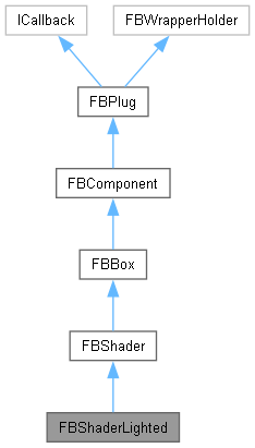

Lighted shader class. More...
#include <fbshader.h>

Public Member Functions inherited from FBShader | |
| FBShader (const char *pName, HIObject pObject=NULL) | |
| Protected constructor. | |
| IObject_Declare (override) | |
This type of shader is the default type used by the application. It allows users to control luminosity, contrast and specularity as well as how the transparency is computed, should it be used.
There are two methods to create a FBShaderLighted object: using the FBShaderManager, or simply by instantiating a class object explicitely.

Definition at line 775 of file fbshader.h.
