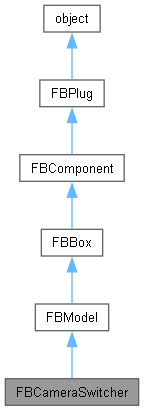

Inheritance diagram for FBCameraSwitcher:
