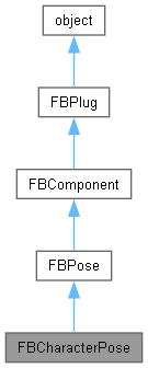

Inheritance diagram for FBCharacterPose:
