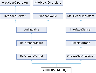

Inheritance diagram for CreaseSetManager:
