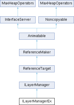

Inheritance diagram for ILayerManagerEx:
