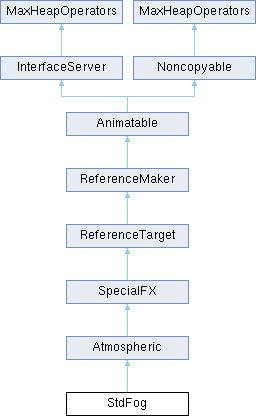

Inheritance diagram for StdFog:

Detailed Description
See also
Class Atmospheric, Class Texmap.
Description:
This class provides access to the settings of the Standard Fog Atmospheric plug-in of 3ds Max. All methods of this class are implemented by the system.
