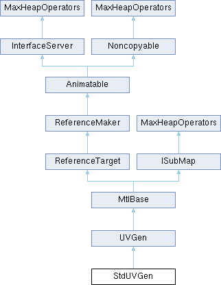

StdUVGen Class Referenceabstract
#include <C:/adskgit/3dsmax/3dsmax/3dswin/src/maxsdk/include/stdmat.h>
Inheritance diagram for StdUVGen:

Detailed Description
See also
Class UVGen.
Description:
This class provides access to the parameters of the 3ds Max UVGen class. These are the settings in the 'Coordinates' and 'Noise' rollups such as UV offsets, angle, blur, noise level, etc. All methods of this class are implemented by the system.
Member Function Documentation
◆ IsStdUVGen()
BOOL IsStdUVGen ( )
inlinevirtual
Remarks
This method asks the question 'Is this class an instance of StdUVGen?'. The derived class StdUVGen implements this to return TRUE. Others use the default implementation to return FALSE.
Default Implementation:
{ return FALSE; }
Reimplemented from UVGen.
