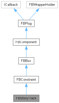

Story Track class. More...
#include <fbstory.h>
