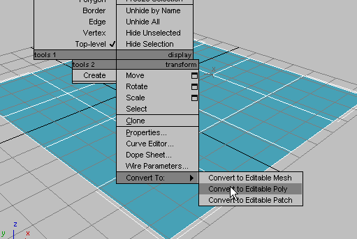

  2. Convert the Plane object to Editable Poly format. If you're not sure how, continue in this step; otherwise, skip to the next step after converting.
    To convert the object, right-click once in the Perspective viewport to exit create mode. This leaves the object selected. Right-click again in the Perspective viewport, and then at the bottom of the Transform quadrant, choose Convert To > Convert To Editable Poly. Alternatively, apply the Edit Poly modifier.
    The object is now an editable poly and the command panel switches to the Modify panel.

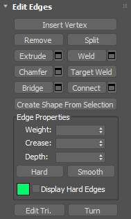

This topic provides detailed information on the edge-specific rollout: Edit Edges. The remaining rollouts are described in their own topics.
Edit Edges rollout
This rollout includes commands specific to edge editing.
