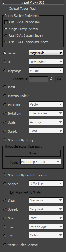

The Input Proxy suboperator lets you bring in particle properties from proxy particle systems—that is, particle flows other than the current one. It always has an O1 (Object data) input to which you wire a Select Object suboperator for specifying the proxy particle system. Additional, optional inputs are I2 for specifying particle IDs and I3 for use as a system or compound index.
Interface
- Output Type
- This read-only field shows the output type of the suboperator, based on the active choice of the type of data to bring in from the proxy particle system.
Proxy System Indexing group
- Use I2 As Particle IDs
- Adds an Integer-type input, to which you can wire a suboperator that outputs the data to use as particle IDs.
This option lets you remix the custom particle data. For example, if the input integer data is { 2, 4, 6, 8, 10, etc.} then the first particle in the current event gets the custom data from a particle with Particle ID = 2; the second particle in the current event get the custom data from a particle with Particle ID = 4, etc.
Typically you'll use just one proxy particle system, so you can leave this setting at the default choice:- Single Proxy System The suboperator references only the input particle system (O1) as a proxy; no further information needed.
- Use I3 As System Index Adds an Integer-type input, to which you can wire a suboperator that outputs the data to use as the ID of the particle system to use as the proxy.
- Use I3 As Compound Index When a Particles suboperator is used to calculate Closest Particle Index, and its Use O1 As Proxy Particles check box is on, then it can calculate the closest particles from several particle systems if the Select Object suboperator that it uses as input has a list of particle systems. As a result, the index of the closest particle should include the index of a particle system and the ID of the closest particle in this particle system. These integer values are compacted into a single compound index that can be used later by other suboperators, for example by the Input Proxy suboperator that has Use I3 As Compound Index turned on. When this option is on, it indicates that the Select Object suboperator used as the input has a list of particle systems, and the properties from proxy particles are gathered from several particle systems. The compound index has the information about the particle system index and the particle ID. You can also create the compound index values from two integer values by using the Convert suboperator.
The remaining Input Proxy settings let you choose the property or properties to copy from the proxy particle system.
