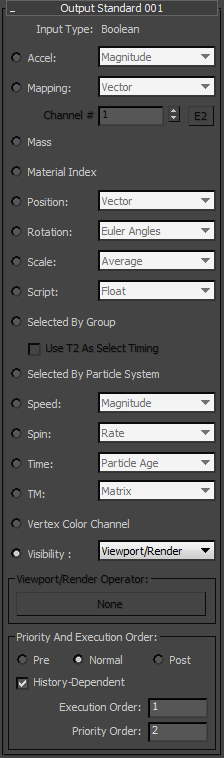

The Output Standard suboperator transfers calculated data into regular particle properties. To use it, choose an input type, and then wire a suboperator that outputs that data type to the input connector on the suboperator in Data View. Output Standard then sends that data out into the particle system to which the Data operator/test belongs.
Interface
- Input Type
- This read-only field displays the data type the suboperator accepts, as determined by the chosen data type. The choices are:
