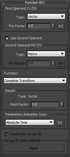

The Function suboperator performs one or more mathematical calculations on one or two input values, or operands. The suboperator provides a wide variety of functions; the specific available calculations depend on the input type or types.
Interface
First Operand group
The first operand is always available. The group box label ("First Operand") is followed by the label of the respective suboperator input; for example, as shown in the illustration above, it's vector input V1, and then "(X)". The latter means that the input value is substituted for X in the chosen function. For example, if Type=Integer, Use Second Operand is off, and you use the default function (in this case) of Square X*X, the input value is used as the first operand and the Function suboperator outputs its square.

- Use Second Operand
- When on, the function uses two operands, with the result that a different set of functions is available on the Function drop-down list. When off, only the First Operand input is used.

These controls are available only when Use Second Operand (see preceding) is on. In this circumstance, the Function suboperator performs calculations on two input values. Depending on the first operand type, the second operand may or may not be chosen by the user. For example, if the first operand is of the Time type, the second operand must also be of the Time type. The suboperator input connections are configured accordingly.
The group box label ("Second Operand") is followed by the label of the respective suboperator input; for example, in the illustration above, the label includes matrix input M2, and then "(Y)". The latter means that the input value is substituted for Y in the chosen function. For example, if both input types are Time and you use the function Addition X+Y, the T2 input value is added to the T1 input value.

- Function
- Choose the formula used to calculate the base output value. The drop-down list contents depend on the first operand data type and second operand data type, if present. The functions are self-explanatory. Modulo and remainder operators differ with respect to negative values. With remainder operators, the sign of the result is the same as the sign of the dividend. With a modulo operator, the sign of the result is the same as the divisor. The remainder operator follows the standards of Fortran, C (C99 standard), and C++ (C++11 standard).
