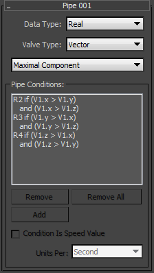

In the case of Valve, the incoming values V1.x, V1.y, V1.z (components of the vector) become the valve controllers. The drop-down list lets you choose how the vector components are used for piping: Maximal Component, Maximal Absolute Component, Minimal Component, or Minimal Absolute Component. With the Vector valve type, the Add and Remove buttons become unavailable because the number of input data channels is fixed at three, similarly to the Boolean valve type, where the number of input data channels is fixed at two.

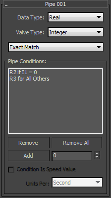

In the case of Integer, the drop-down list shows two choices: Intervals, which is the standard mode for most valve types, and Exact Match, which tests for equality of the specified values only.
