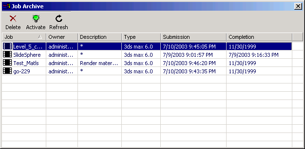

Jobs are placed here when you select a job from the Job list on the Queue Monitor and click the Archive Job command. This brings up the Backburner Job Archives dialog Jobs are also placed in the Job Archives if you set them to automatically archive when the rendering is completed.

This dialog consists of a toolbar and list of archived jobs.
Toolbar
The Job Archives toolbar has three commands.
Delete
Deletes a selected job from the archive. You are warned and must accept confirmation before the deletion to occurs. This button is active only when a job is selected.
Activate
When you select a job from the list, you can click the Activate button. When a job is activated, it is removed from the Job Archives and placed back in the Job list in the Queue Monitor. Then you can choose to Edit Settings and restart the job.
Refresh
Forces the Job Archives dialog to update the information shown in the job list
Job List
The Job List shows the Job Name, Owner, Description, Type (render plugin), original Submission date, and Completion date. Unlike other lists in the Queue Monitor, you cannot add or remove columns. You can make multiple selections of jobs by holding down either the Shift or Ctrl keys.
