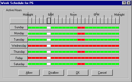

By default, all servers are available at all times. Using the Queue Monitor's Week Schedule feature, you can arrange the hours during which each server is available for network rendering.
  • Queue Monitor > Highlight a Server and right-click. > Week Schedule
  • Queue Monitor > Highlight a Server. > Servers menu > Week Schedule
You can specify certain hours for any day of the week. This is useful, for example, if the server is used as a modeling workstation during normal business hours and you do not want it being used as a network render server during this time.
Procedures
To schedule a set of active hours for a server or servers:
  1. In Queue Monitor's Server list, right-click a Server and choose Week Schedule, or select one or more Servers and choose Servers menu Week Schedule.
  2. In the dialog that appears, select a time using one of the following methods:
    • Select a one-hour block for network rendering by clicking one of the top buttons.
    • Select an entire day by clicking a side button.
    • Select the entire week by clicking the large top-left button.
      The selection is shown in white.
  3. Click the Allow button. The selection is shown in green. (By default, all hours are allowed).
  4. To apply the time selection to the selected Server, click OK.
To schedule hours when servers are unavailable:
  1. In Queue Monitor's Server list, right-click a Server and choose Week Schedule, or select a Server and choose Servers menu Week Schedule.
  3. Click the Disallow button. The selection is shown in red.
