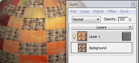

When a layer has a layer mask, a thumbnail image of the mask appears on the right side of the layer’s entry in the list:
To work with the layer image, click the layer thumbnail on the left side of the list entry; to work with the layer mask, click its thumbnail on the right side. When the layer mask is active, you can modify it by painting or by loading a bitmap, as with the standard layer image.
The layer mask is a grayscale image. Black pixels hide the current layer image, revealing the underlying layer; white pixels reveal the current layer; and shades of gray make the current layer translucent.
Layer 1 uses a checker bitmap as a layer mask to reveal the background layer in a regular pattern.
