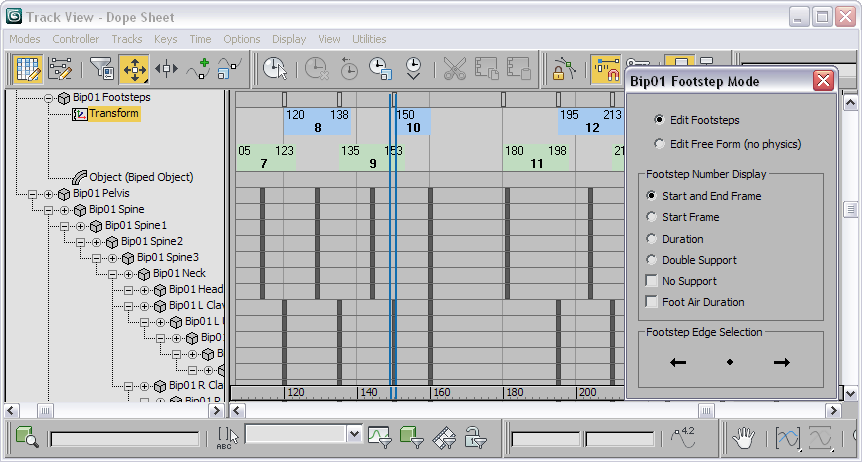

- Expand the footstep key display for the biped.

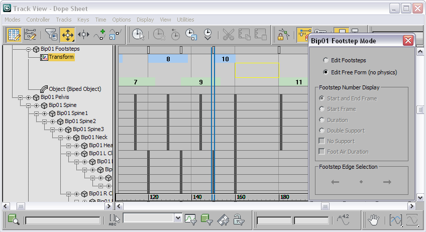

- Right-click the footstep key display area. The Footstep Mode dialog appears.
- In the Footstep Mode dialog, choose the Edit Free Form (no physics) option.
In each airborne period in Track View, a hollow yellow box appears.

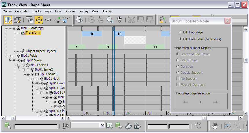

- In the Track View footstep key display, click inside the yellow box for the airborne period for which you want to suspend gravity. This fills the yellow box, indicating that vertical dynamics are suspended for that period.
Play the animation. The biped uses vertical dynamics during all footstep motions except the freeform period.
No vertical dynamics during freeform period, then return to vertical dynamics during next airborne period.
