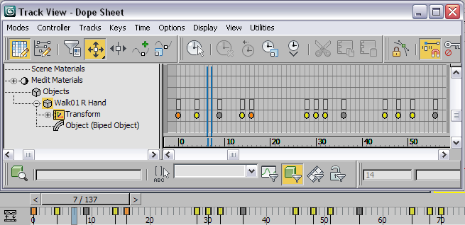

Color-coded Keys in Track View and on the Track Bar
Biped IK keys as displayed in Track View and on the track bar use the following color scheme:
- Orange for planted keys
- Yellow for sliding keys
- Blue for body-space IK keys with a nonzero value for IK Blend
All other keys use the default color: gray.
Color-coded biped keys in Track View and on the track bar
