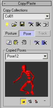

Copying the Entire Biped Pose
The Copy Pose functionality allows you to copy the rotation and position of all the parts of the entire biped at once. It doesn't contain the animation track data, only the individual keys at that frame, and the buttons to copy tracks are unavailable when Copy Pose is in use.
Pose shows the whole biped
You can create animation using Copy Pose by simply copying different poses to the same biped at different frames, and setting keys for those poses. Copy Pose works with the character studio Set Key buttons found on the Key Info rollout, and with Auto Key mode.

To copy the entire pose of a biped:
Select any part of the biped whose pose you want to copy. - On the Copy/Paste rollout, click
(Create Collection) and rename the new collection Biped Pose. - Click
(Copy Pose). - Advance to a new frame or select another biped.
- Turn on
. - Click
(Paste Pose) or
(Paste Pose Opposite). Tip: You can use Paste Pose Opposite to create symmetrical runs and walk cycles.
