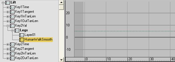

In Track View, the CATMotion data is held in is held on the CATParent, in its respective CATMotion layer.
The controllers mirror the CATMotion editor hierarchy exactly. Each controller is visible and each preset layer present.
The CATHierarchy in Track View for a standard rig
Tip: The easiest way to access the animation parameters for a specific CATMotion controller is to click on the Track View button on the panel for that controller in the CATMotion editor.
To animate the Pelvis Lift value for the 2nd Knot:
- In the CATMotion editor, access PelvisGroup
Pelvis
Lift.
- Click Curve Editor. Track View opens to show all parameters for the selected controller.
- Expand Key2Val.
- Insert and edit animation keyframes as required.
