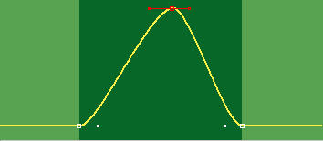

The curve you see on the FootPlatform
Lift panel is useful for helping to create the result you want in the animation for that controller, but you can also see the actual result in Track View.

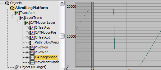

- Right-click the selected FootPlatform in the viewport and choose Curve Editor.
The Curve Editor opens showing the curve for the CATStepShape track.

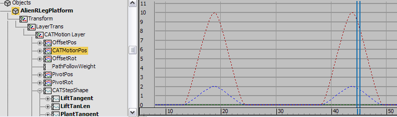

- Click the CATMotionPos track. The information for the selected element is held in this controller.
Here you can see the graph that represents the trajectory for the selected Footplatform, as compared to the CATMotion graph for the Footplatform controller (following).
