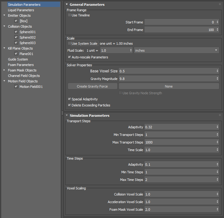

Use the Solver Parameters panel to configure parameters for each solver in the simulation.
- Simulation Parameters
- Sets top-level simulation parameters such as scale, base voxel size, and gravity settings, as well as transport and time steps.
- Liquid Parameters
- Sets the liquid properties for each solver and applies presets.
