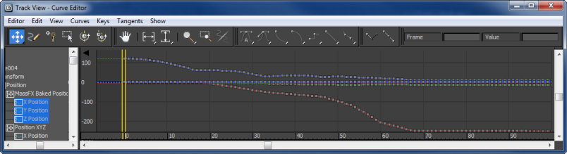

- Select an animated object in a viewport, then right-click the object and choose Curve Editor.
Track View opens in Curve Editor mode. Only animated tracks of the selected object are highlighted in the Hierarchy window of Track View - Curve Editor. This is the default behavior.
All keys belonging to highlighted tracks are affected by the Retime tool, within the horizontal confines that you'll define shortly by placing markers.

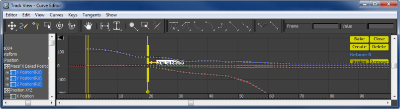

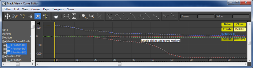

(Retime Tool). Three things happen:- The message "Double click to add retime markers" appears in the Key window.
- The Retime tool controls appear in the top-right corner of the Key window. These consist of yellow buttons labeled Bake, Close, and so on. Also here is a single entry in the Retimer list: Retimer 0.
- Each highlighted item in the Hierarchy window changes in two ways:
- A small icon consisting of a circle around a + sign appears to the left of each item. This indicates that an Ease curve has been assigned to the track. Because you haven't done any actual retiming yet, the Ease curve contains no data at this point.
- To the right of each item, the text "(R0)" appears. This indicate that the track has been assigned to Retimer 0, which is the only retimer that exists at this point.
- Position the mouse cursor in the Key window at the frame to start or stop retiming and double-click.
A Retime marker appears in the window where you clicked. It takes the form of a vertical yellow bar and bears the legend "Drag to Retime."

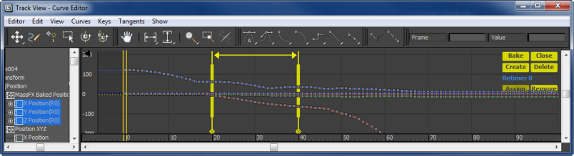

- Move the mouse to a different frame and double-click again.
A second marker appears, as does a horizontal double-headed arrow between the tops of the two markers.
Retiming markers at frames 20 and 40
Take a moment to observe the markers. Each has a thin line at the top and bottom, a thicker part in the middle, and a small X in a circle at the bottom.

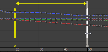

The marker moves but no retiming occurs. Before you start retiming, you can reposition marker freely.

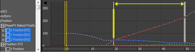

The second marker was moved from frame 40 to frame 34.

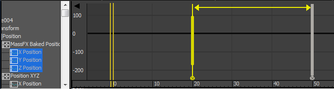

- When the marker positions are correct, drag either marker by the thick central part.
Now retiming takes place. If you move the markers farther apart, the time between them expands and the animation they contain slows down. If you move them closer together, the animation speeds up. Meanwhile, time outside and adjacent to the marker you drag moves in the same direction by the same amount. Thus the animation outside the marker pair remains intact, but takes place at a different time.
After retiming, the animation between frames 20 and 34 extends between frames 20 and 50.
As a result, the keys are farther apart than the others and their motion is slower.

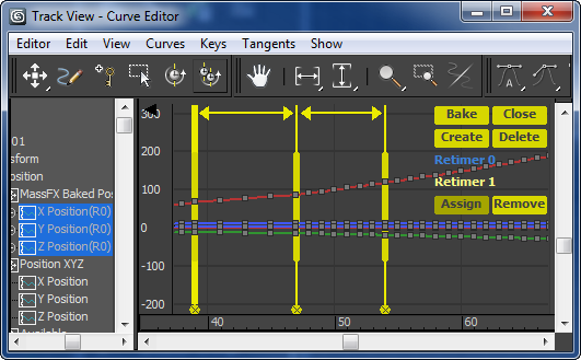

- In the bank of buttons in the top-right corner of the Track View window, click Create.
This adds a second retimer, Retimer 1, to the list. Retimer 1 is highlighted, as indicated by the blue color of its label. The Retimer 0 label turns yellow to show that it is not highlighted.
- Click Retimer 0 in the list.
The label turns blue and the animated tracks' curves and keys again become visible.
- Activate Retimer 1 again and highlight a few tracks in the Controller window hierarchy list; say, X Position(R0) and Y Rotation(R0).
- Click the Assign button near the top-right corner of the Key window.
Now you can see only keys and curves from the highlighted tracks, whose names change to X Position(R1) and Y Rotation(R1). This indicates that the tracks are under the control of Retimer 1.
Now you can see the remaining tracks that are still under the control of Retimer 0.
In this way you can freely reassign tracks among different retimers. Even if you need a different retimer for each animation track, this is easy to do.

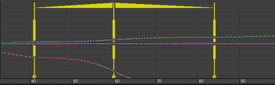

- Retiming markers
- When the Retime tool is active, double-click in the Track View Key window at any time to add a vertical yellow marker. Each neighboring pair of markers encompasses a time span, which you warp by moving either marker. Note: The Retime tool warps time with an Ease curve, thus affecting underlying keys. However, keys need not be present within a time span to warp its animation.
Retimer 0 is active with three markers.
Each marker has the following features:
- Before retiming, you can adjust the marker's position by dragging it by the thin upper or lower part. After retiming, this feature is no longer available.
- To perform retiming, drag the marker horizontally by the thick central part. After retiming, the entire marker assumes this thickness, indicating that adjustment without retiming is no longer available. Retiming affects time adjacent to the marker on both sides. Specifically:
- If no marker is adjacent to the moved marker, retiming simply moves the animation.
- If the moved marker has an adjacent marker, moving the marker towards its neighbor compresses the intervening time, and moving it away from its neighbors expands the intervening time. Time beyond neighboring markers on either side is not affected.
- To delete a marker, click the small X button at its bottom end.
Note: If you retime with a marker (so it becomes thick), and then adjust the position of an adjacent marker by dragging it by the thin part, the latter then becomes thick as well, so it can then be used only for retiming. - Time Span
- When two or more markers are present, a horizontal line connects the tops of each adjacent marker pair. By default, this line is a double-headed arrow that simply indicates the time span between the two markers.
Default (linear, unlocked) time span lines between markers
