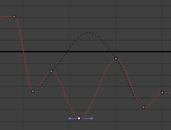

Buffer Curves keeps your original curve position in a buffer, allowing you to view the original curve and revert back to it even after making several changes to the curve. You can also reposition the buffer curve to a new position or swap the buffer curve with the actual curve.
- On the Buffer Curves toolbar, click Use Buffer Curves.
The Show/Hide Buffer Curves enables by default.
- In the Key window, select and move a key or track.
The Buffer Curve displays as a black dotted line.

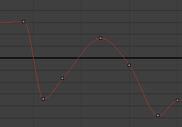

Original Curve
Buffer Curve shown as black dotted line
