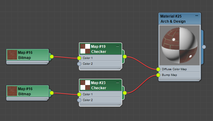

Make Node Unique
If the child node is instanced, Make Node Unique makes the child unique, but does not duplicate the children of the child.

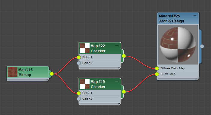

Make Branch Unique
If the child node is instanced, Make Branch Unique makes the child unique, and duplicates the children of the child, as well.

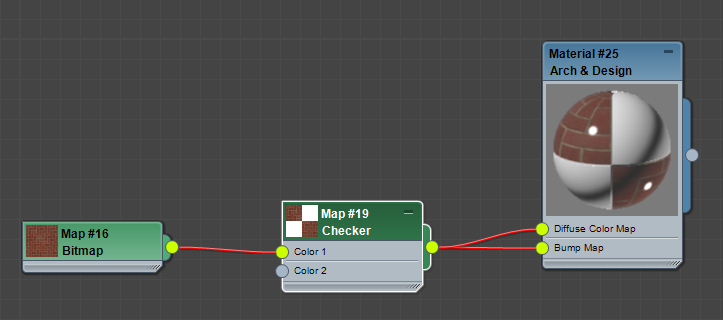

An instanced map
(Branching wires always indicate instancing.)
After right-clicking a wire between the bitmap and material, and choosing Make Node Unique
After right-clicking a wire between the bitmap and material, and choosing Make Branch Unique
