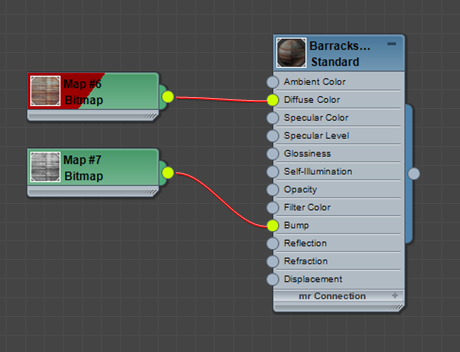

A material with one map for diffuse color and another as the bump map

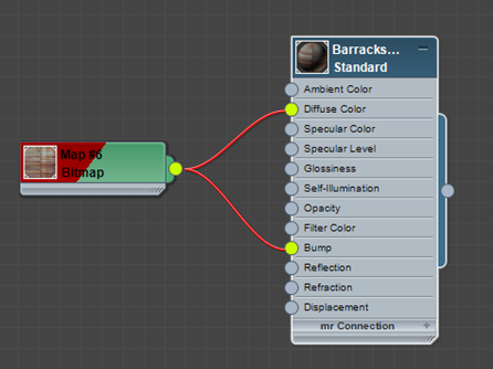

A material with a single map used as both diffuse color and bump maps

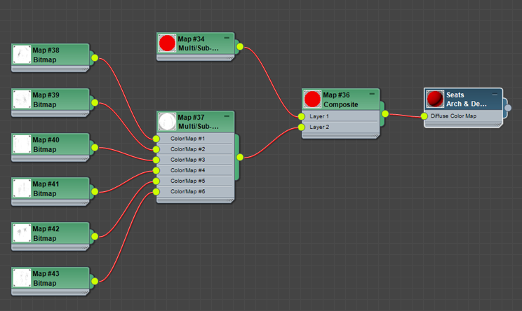

Some maps combine other maps, and some materials can combine sub-materials, so a material tree can have more than two levels.
A four-level tree that uses Multi/Sub maps and a Composite map
