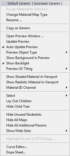

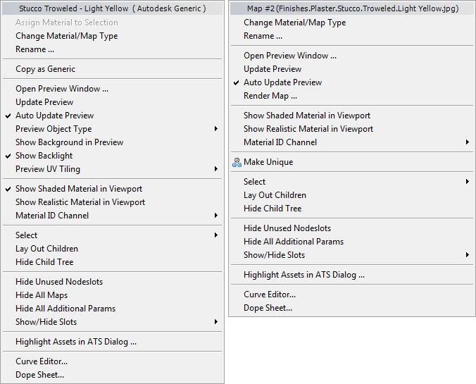

Right-clicking a material or map node displays a menu that has a variety of options for displaying and managing the material or map.
The right-click menu also appears when multiple material or map nodes are selected. This way, you can apply an option to multiple nodes at once; for example, to show additional parameters for a group of nodes. If the option you choose does not apply to a node in the selection (for example, Show Material for a controller node), the option is ignored.
Left: Right-click menu for a material
Right: Right-click menu for a map

Right-click menu for an Autodesk Material node
- Copy as Generic
- Appears for Autodesk Material nodes other than an Autodesk Generic node. Converts the Autodesk Material to an Autodesk Generic node, and displays the node in the active View of the Slate Material Editor. If the original material includes maps, the map nodes are copied as well.
This option can lose some type-specific information. For example, Autodesk Generic does not have a Flecks component such as Autodesk Metallic Paint does.

- Make Unique
- This appears if you right-click a map node that is an instance. (Branching output wires indicate an instanced map.) Make Unique makes the node unique by duplicating it.
This choice is equivalent to Make Branch Unique on the right-click menu for a wire: Children of the node you are duplicating are duplicated as well.

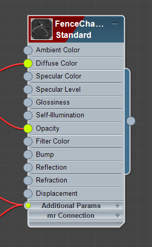

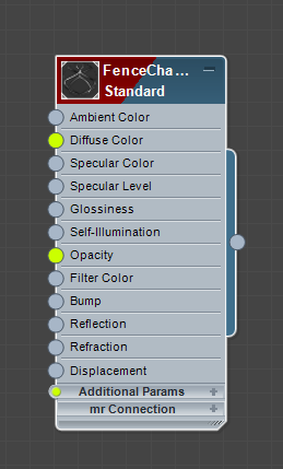

- Hide Unused Nodeslots
- For a selected node, toggles display of the unused slots when the node is expanded.
Keyboard shortcut: H
Menu choice: View
Toolbar button:
(Hide Unused Nodeslots)
- Hide/Show All Maps
- Hides or shows all map slots for this node.
The nodes themselves remain visible, but the wires to them are hidden, and the node is collapsed or expanded.
- Hide/Show All Additional Params
- Hides or shows the Additional Param[eter]s section for this node.
- Hide/Show All mr Connection
- Hides or shows the mr Connection section for this node.

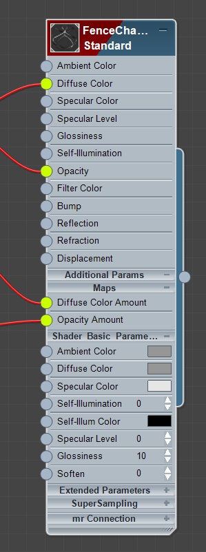

- Show/Hide Slots
- Displays submenus that let you choose which material or map components to display as node slots.
- Maps (Appears only for materials, and for maps that have mappable components.) This submenu lists the individual mappable components of the material or map, such as color values and numeric settings. Choose a component to either hide it or display it.
- Additional Params This submenu lists the additional, nonmappable settings for the material or map. Choose a component to either hide it or display it.
When Additional Parameters or mr Connection settings are displayed, they have their own Open/Close (+/–) icon, like the node itself.
A node with the Additional Params displayed but closed
The same node with the list of Additional Params
Shader Basic Params group openedNote: You can edit the value of additional parameters in the node display itself. In general, though, it is easier to edit parameters using the Parameter Editor.Both the Maps and Additional Params submenus have two choices that follow the individual component entries:
- Show All Shows all maps or additional parameters.
- Hide All Hides all maps or additional parameters.
