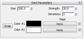

Interface
Size
Sets the relative size of dents. As the size increases, the number of dents decreases when other settings are the same. Default=200.
Decreasing Size creates the appearance of tiny dents spaced fairly evenly. The effect can resemble a "sand-covered" surface.
Increasing Size creates the appearance of distinct grooves and gouges on a surface. The effect sometimes has a "hardened lava" look.

Strength
Determines the relative coverage of the two colors. Higher values increase the coverage of Color #2, while lower values increase the coverage of Color #1. Default=20.
When using Dent as a bump map, increasing the Strength value typically makes the dents look deeper.

Iterations
Sets the number of calculations used to create the dents. Default=2.
Dent is based on a fractal-noise equation. During rendering, a dented surface is calculated one or more times to produce the finished effect. Each calculation pass is an iteration.
As a surface is calculated, each iteration adds to the number of dents and the complexity and randomness of the final surface (dents become dented).
The Dent texture requires heavy calculation, especially at higher iterations. This can slow down rendering time considerably.

Swap
Reverses the position of colors or maps.
Colors
Allows choice of two colors where appropriate for a color component (such as Diffuse). Defaults=black for Color #1 and white for Color #2.

Maps
Replaces colors with maps in the dent pattern. The checkboxes enable or disable their associated map.
You can assign maps to one or both of the Dent color slots. Any kind of map can be used, including Dent. The map overrides the assigned color, which has no effect.
