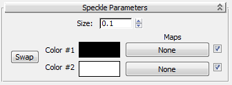

Interface
Size
Adjusts the size of the speckles. Use this to make the speckles match your geometry. Default=0.1.
Swap
Exchanges the two color components.
Color #1
Represents the color of the speckles.
Color #2
Represents the color of the background.
Click one of the swatches to display the Color Selector and change one of these component colors.
Maps
Click a button to assign a map that replaces one of the color components. Turning off the checkbox turns off the associated map (the Speckle map reverts to the associated color component).
