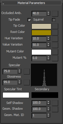

- Occluded Amb.
Controls the bias of the ambient/diffuse contributions of the illumination model. A setting of 100.0 renders the hair with flat lighting. A value of 0.0 is lit only by scene light sources, typically resulting in a higher-contrast solution. Default=40.0. Range=0.0 to 100.0.

- Tip Fade
Applies only to mr prim rendering. When on, the hair fades to transparent toward its tip. When off, the hair is equally opaque for its entire length.
- Squirrel
- When on, there is a sharper gradation between the root and tip colors, and more of the tip color is visible.
- Tip Color
Hair color at the tips, farthest from the growth object surface. To change the color, click the color swatch and use the Color Selector.
- Root Color
Hair color at the roots, closest to the growth object surface. To change the color, click the color swatch and use the Color Selector.

- Hue Variation
The amount by which Hair varies the color of the hairs. The default value results in natural-looking hair. Default=10.0. Range=0.0 to 100.0.
- Value Variation
The amount by which Hair varies the brightness of the hairs. The default value results in natural-looking hair. Default=50.0. Range=0.0 to 100.0.

- Mutant Color
The color for mutant hairs. Mutant hairs are randomly selected, based on the Mutant % value (see following), and receive this color.
One example of mutant hairs are the gray hairs that appear as we age.
- Mutant %
The percentage of hairs that receive the mutant color (see above).
You can animate the Mutant % value to produce, for example, a rapidly aging character. Default=0.0. Range=0.0 to 100.0.

- Specular
The brightness of highlights on the hairs.
- Glossiness
The relative size of highlights on the hairs. Smaller highlights result in glossier-looking hair.
The combined results of the Specular and Glossiness settings appear in a graph to the right of the two parameters.

- Specular Tint
This color tints specular highlights. Click the color swatch to use the Color Selector. Default=white.
- Secondary
- Sets the color of a wider, secondary highlight that is offset from the main specular highlight. Simulates scattering of the highlight, though it is not a physically accurate effect.
Tip: For a naturalistic effect, choose a Secondary shader whose color is intermediate between the Specular Tint and the Tip Color.
- Self Shadow
Controls the amount of self-shadowing; that is, hairs casting shadows on other hairs within the same Hair And Fur modifier. A value of 0.0 disables self shadowing, while a value of 100.0 results in maximum self-shadowing. Default=100.0. Range=0.0 to 100.0.

The amount of shadow contribution hair receives from geometry in the scene. Default=100.0. Range=0.0 to 100.0.
- Geom. Mat. ID
The material ID assigned to geometry-rendered hair. Default=1.
