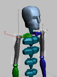

- Prepare a biped with five twist links on each upper arm.
- Exit
(Figure Mode), and then expand the Twist Poses rollout. -
Select the right upper arm. The rollout controls are enabled because you selected a three-DOF limb.

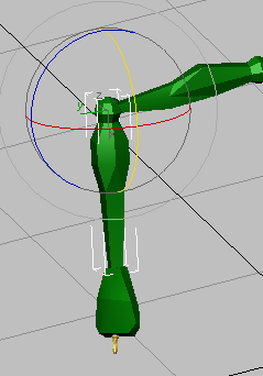

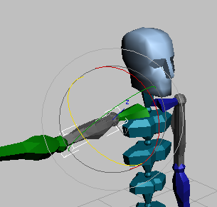

Rotate the upper arm locally around its Y axis so it extends to the side.
- Click Add to create a new pose. Rename it Arm At Side.
This new pose resets the current Twist value of the twist links.
Rotate the upper arm locally around its X axis. The twisting in the upper arm is calculated based on the limb's proximity to the saved poses.
Rotate the upper arm to verify the twist links.
